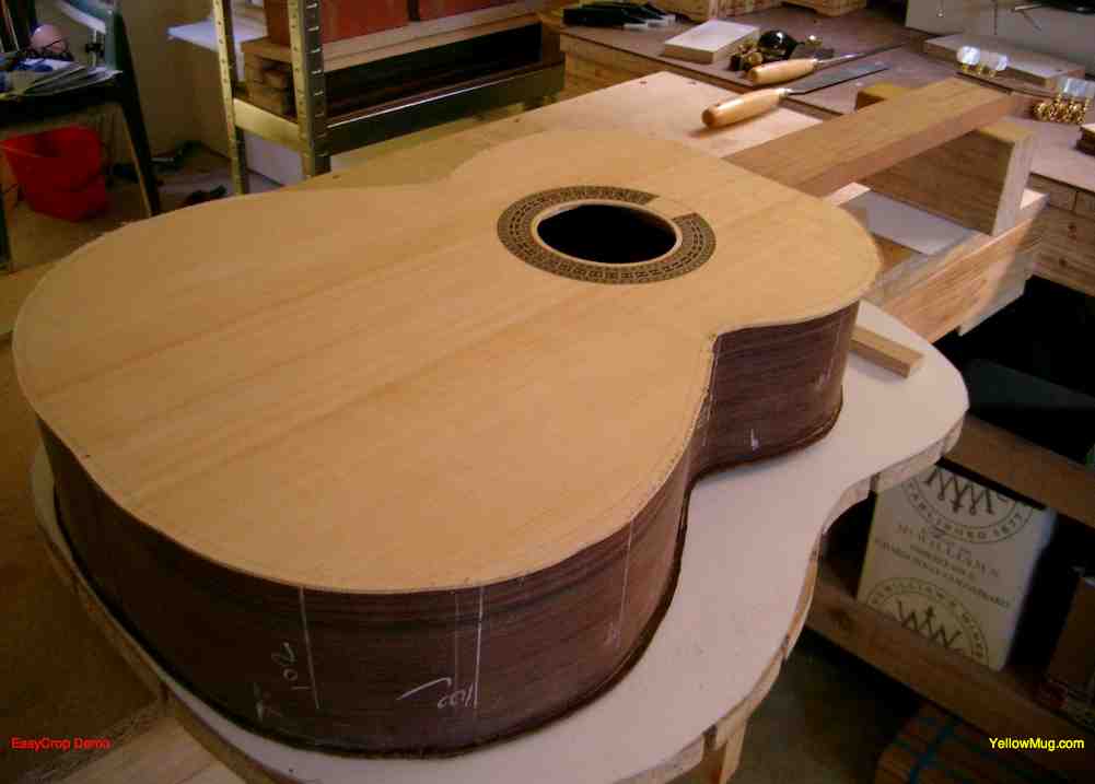

Finally got the back glued on the classical yesterday and this morning it
came off the workboard for the first time and is starting to look like a
guitar.
Not quite as visually impacting as many of the instruments being made by
others in this forum but its my first classical so Ive kept things fairly
simple......most of design is based on a Torres instrument and materials
are noting adventurous...rosewood back and sides, Sitka top.
First time posting photos, please let me know if the pic doesn't cmoe out
right.
Cheers Martin

PostPosted: Sun Mar 05, 2006 2:24 pm
Posts: 2353
nice work Martin. Let us know how it turns out when you get the strings on it.
Robbie
PostPosted: Sun Mar 05, 2006 2:30 pm
Posts: 720

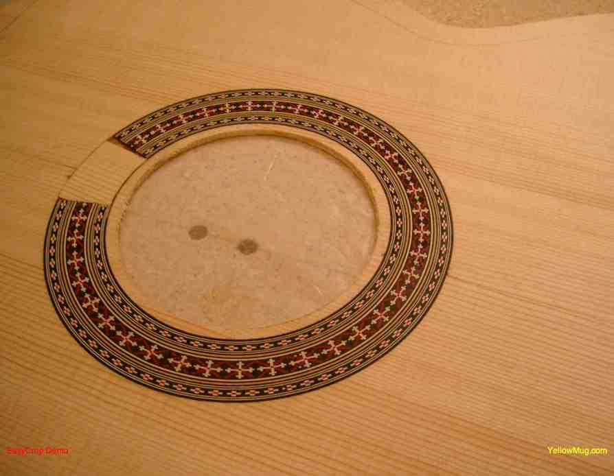

Hi Martin,
            Good looking work so far . I always take my hat off to people who pipe bend their sides.
I really like the look of that rosette . Did you make it or buy it ?
   How about a closer shot of it.
Regards KiwiCraig

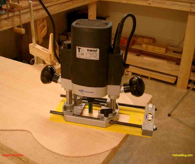

KiwiCraig,
The Rosette is a stock standard Stewmac job (see photo). Getting the thing fitted was a tale of much woe and nashing of teeth. Ended up going through 2 spruce tops before I got it right:
Attempt 1 - used Dremel and Stewmac rosette jig. Routed one of the channels in the wrong place.
Attempt 2 - used Dremel again and routed the channels in the right place but while routing the depth adjustment on the router jig slipped and I went right through the sound board!
Attempt 3 - Used a Trend T5 router and a circle cutting jig (see photo) and did a perfect job. Also made a much cleaner cut than the Dremel.
Cheers Martin
PostPosted: Sun Mar 05, 2006 11:19 pm
Martin, your box looks very neato and your craftmanship seems flawless! Good job mate and good on ya!

Neato..yes. Flawless.....no. Being my first classical there are a few flaws in this instrument:
1. Sides dont mate flawlessly into the heel block...theres a visible gap. I hand sawed the slots and was slightly out with angle of the slot.
2. Problems as described in previous post with routing of rosette channel.
3. Stuffed up trimming back braces the first time around...ended up replacing all back braces (replaced cedar braces with sitka spruce) and most of back lining.
4. Headstock veneers were too thick and looked awful when glued up. Planed them off and slapped on some thinner veneers.
5. hand cut the channel for back seam inlay....cut it a tad too wide for the inlay I had selected but luckily had a slightly thicker inlay that wasn just as nice.
Lots of mistakes but one's I've learned from.
Cheers Martin

PostPosted: Mon Mar 06, 2006 7:15 am
Looks good, Martin. I'm most interested in your revolutionary tuning gear arrangement in the first photo.
PostPosted: Mon Mar 06, 2006 9:00 am
Posts: 2951
Last Name: Beaver
City: Lake Forest
Don't forget, He's from down under. Most things seem a little upside down to us, but not to worry...It all comes out in the end.
Good job Martin Joe Beaver38782.7100347222
Joe Beaver
Maker of Sawdust
PostPosted: Mon Mar 06, 2006 10:01 am
Posts: 1055
[QUOTE=CarltonM] Looks good, Martin. I'm most interested in your revolutionary tuning gear arrangement in the first photo. [/QUOTE]
Aaaaand the chocolate fish goes to Mister Carlton!!!
I was actually sitting swooning over my baby last night and suddenly noticed something strange about the machine heads and then there was the horrible thought that by then half the world had probably noticed as well. I then decided to say nothing about it and see who would be the first OLF'er to notice.
It does pose the question though....why do the tuners HAVE to go on the underside of the headstock????
Cheers Martin
PostPosted: Mon Mar 06, 2006 10:05 am
[QUOTE=kiwigeo]Aaaaand the chocolate fish goes to Mister Carlton!!![/QUOTE]
Mmmm...chocolate! I'll start at the tail! Should I use lemon?
